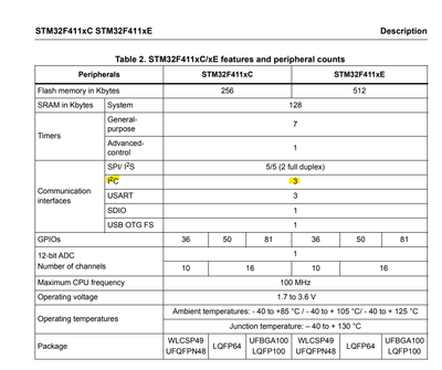

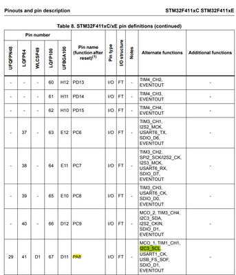

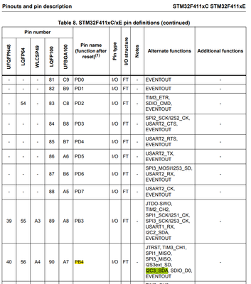

in cube mx (cube ide version Version: 1.19.0) i can select i2c3 for STM32F411CEU6
bun can someone verity that this chip in ufqfpn48 support i2c3??

Hello @Lios ;
As mentioned in the datasheet, the STM32F411CEU6 device supports the I2C3.
Thank you.
Kaouthar

2025-08-05 4:41 AM
How is this a possible major bug? What suggests anything is even wrong?
