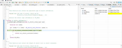

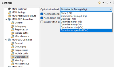

I use STM32CubeIDE to compile the RT Thread project. When the optimization level is selected as "Optimize", local variables will be optimized,
Only when "Optimize for debug" is selected, local variables will not be optimized and the program can run normally,
May I ask why this is happening and what should I do?
Using 'Optimize for debug' will result in losing a lot of flash

The local variable has been optimized, causing the program to run abnormally.
RT Thread is a third-party library with a lot of content; It still uses local variables in many places;
I added a volatile int index, and the index is normal, but there are still many others....
I compiled on Keil and used (- O3), and the program can run normally. Why doesn't work on STM32CubeIDE for "Optimize" ?
I don't think it should optimize my local variables.

@asdss wrote:When the optimization level is selected as "Optimize",
There are also several other options:
For details of what they do, see:
https://gcc.gnu.org/onlinedocs/gcc/Optimize-Options.html

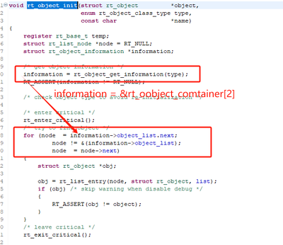

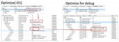

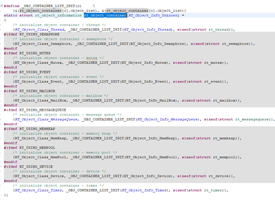

I delved deeper into the comparison and found that the content pointed to by 'rt_oobject_comtainer' seems to be incorrect,
Please refer to the following figure. I compared the pointing values of rt_ort_comtainer under Debug and Optimize (O1) optimization levels
Under Optimize (O1) optimization level:
After obtaining the program information&rt_oobject_comtailer [2], it cannot exit the for loop, which will generate a hardware error interrupt approximately 5 times.
The content of the rt_oobject_comtailer linked list is generated to: I am not very familiar with what the compiler has done to cause the content of rt_oobject_comtailer to deviate.
Please help me, thank you
