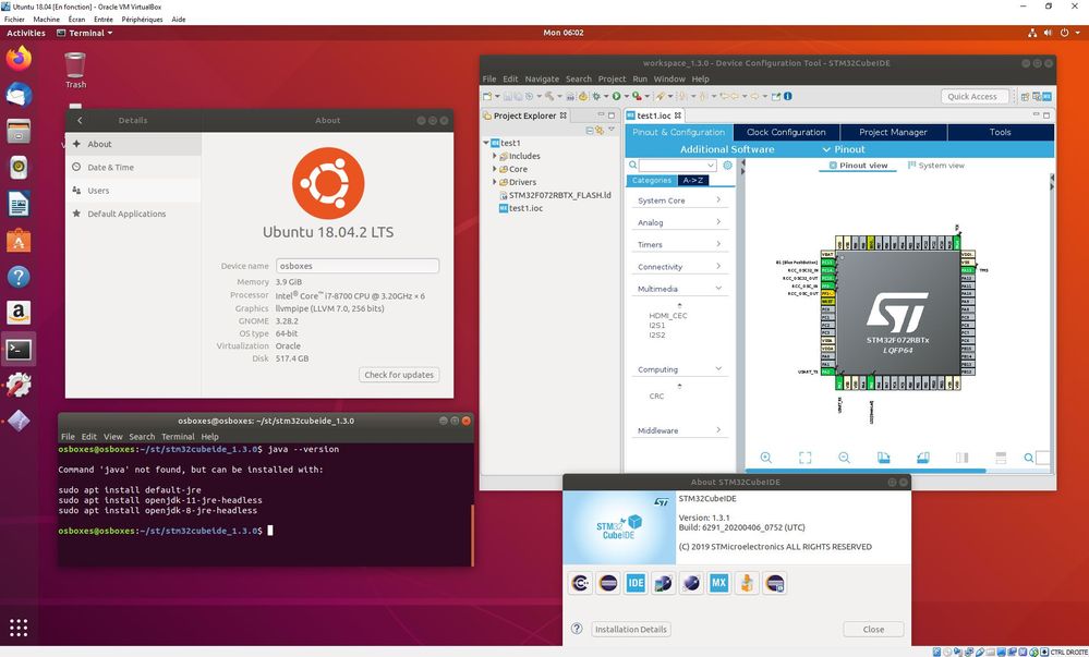

I can't get the STM32CubeMX perspective to work reliably when running STM32CubeIDE on an Ubuntu 18.04 virtual machine. I always get the pinout view of the device, but the left pane of device features doesn't draw, neither does the row of tabs at the top (should say Pinout & Config, Clock config, Project Manager, Tools). Lots of other stuff works, such as the board selector and compiler, so I doubt it's related to running on a VM.
I've tried many variations:
· Ubuntu 20.04 (although that's not listed in the versions tested by ST, whereas 18.04 is claimed to work)
· Different JVMs including the latest OpenJDK 8, OpenJDK 11, Oracle JDK 8, editing stm32cubeide.ini as appropriate and confirming that they're in use through the Installation Details dialog
· Windows and Mac OS hosts
· Different RAM sizes.
· Upgrading GTK
The problem can always be reproduced by creating a freshly installed Ubuntu 18.04 virtual machine.
· Create a new Virtualbox VM from Ubuntu 18.04 .iso, 64-bit, 4GB RAM, 20GB hard drive.
· Allow Ubuntu to install on the guest, minimal installation, typical defaults.
· Allow the guest to install any available updates.
· Install guest additions
· Install STM32CubeIDE 1.3.0 Debian bundle from ST.
· cd /opt/st/stm32cubeide_1.3.0
· sudo ./stm32cubeide
· Accept default workspace path
· The Information centre shows, but wait for it to discover pending updates. It finds an update to version 1.3.1, allow it to install.
· Manually restart STM32CubeIDE so you can run as sudo. It displays version 1.3.1.
· File / New STM32 Project. The STM32 target selector downloads a heap of stuff and displays correctly. Use the board selector to create a new project for a Nucleo F072 board, project name = test1, default options.
· The firmware package downloads and the project is created, but the STM32CubeMx perspective is broken and unusable. The java process consumes 100% CPU time and continues to do so until I quit STM32CubeIDE. I suspect it’s entering some infinite loop.
On the same VM I can install the standalone STM32CubeMX and it works every time (with openjdk-8).
In STM32CubeIDE the board selector, editor and compiler all work perfectly so I doubt it’s anything to do with any of the VM settings or a broken Ubuntu installation. In any case I’ve tried reinstalling Ubuntu a few times and it’s always the same result.
2020-06-29 1:37 AM
Works like a charm on my side.
Have you got a try allocating more memory to your VM? 4Go sounds quite few considering such modern IDE ...
Same I would recommend >1 cpu if VM setup ... you'll take benefit of some distributed jobs (compilation, ...) helping overall IDE performances ...

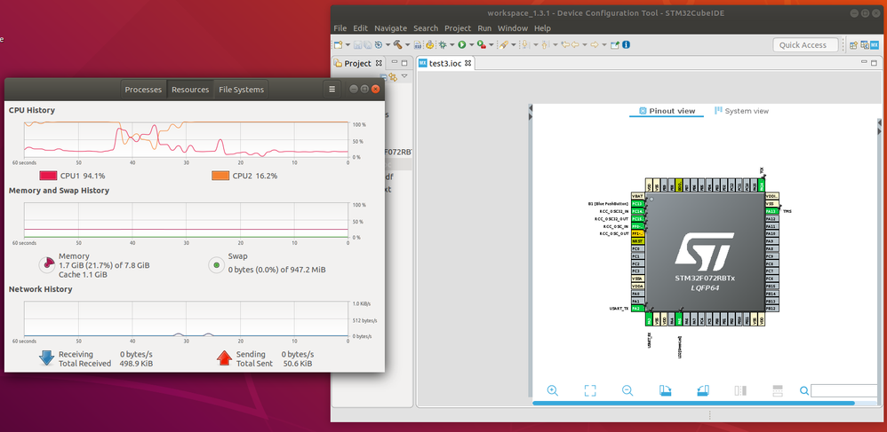

Cool. Glad it works for you. Are you using 18.04 under VirtualBox? Have you installed any software other than STM32CubeIDE that may be helping it? Are you using the JVM that ships with CubeIDE or another one? Do you run it as sudo or as a standard user?
I just tried it with 8G of RAM and 2 processors. Same result, see attached screenshot. RAM usage is 1.7G, which is the same as when I'd allocated 4G so that's extremely unlikely to be the problem. One CPU is still kept busy by the JVM, although it's interesting to see the load fluctuated between the two at one stage. In any case, it still doesn't draw properly even when left idle for minutes.
I doubt it takes another 4G of RAM and a processor to redraw the few missing bits :) I'm calling it a bug, not a resource issue.

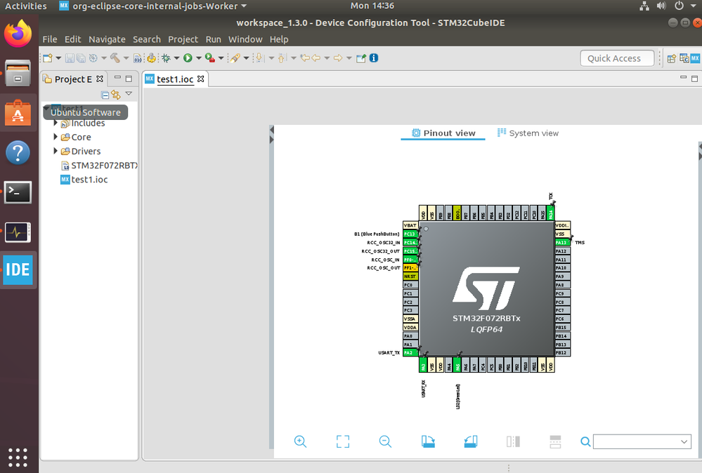

2020-06-29 3:04 AM
Here is my VM snapshot. STM32CubeIDE 1.3.1 + Ubuntu 18.04 + 4Go memory + STM32CubeIDE native java (none available as part of my VM). I've got a try based on same device as you.
Not helping you sorry but works for me.
