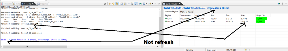

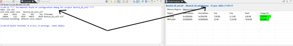

2022-01-21 2:08 AM
Seems the "Build Analyser" view is not well refreshed sometimes (that's why I was confused in the first place)If I rebuild, the Build Analyser data doesn't update. Sometimes it works sometimes not. Havent figured out yet what could be the root cause
