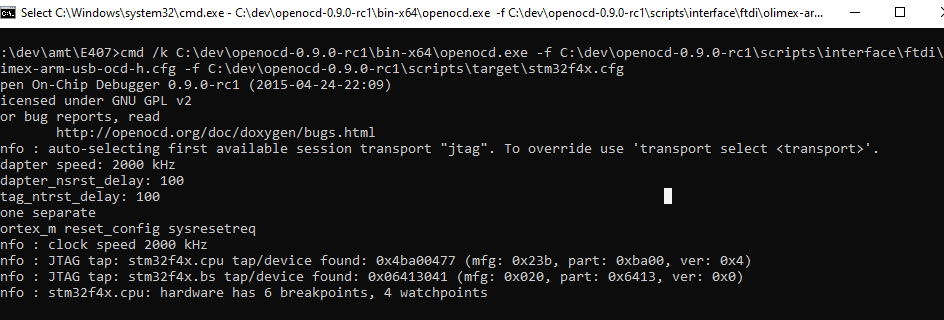

I installed the drivers (WinUSB (v6.1.7600.16385)) for the ARM-USB-OCD-H using Zadig, then run openocd (openocd-0.9.0-rc1).

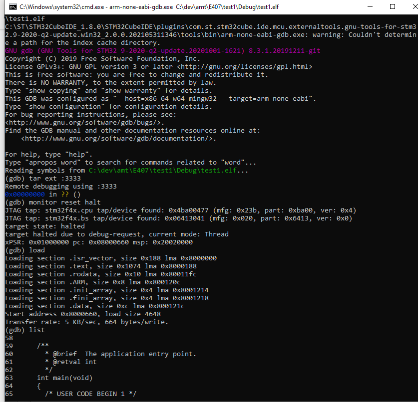

To test it, I created and built a simple program using STM32CubeIDE. In another terminal, I run arm-none-eabi-gdb.exe. I can connect to the openocd and program the board.
Everything is working so far.

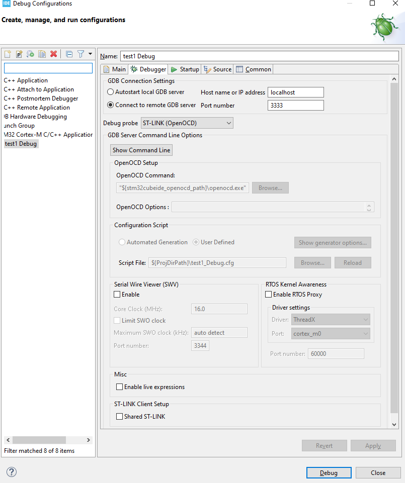

But when I loaded it using STM32CubeIDE (Version: 1.8.0, Build: 11526_20211125_0815 (UTC), I got this error: Could not verify ST device!
OpenOCD reported that: invalid command name "WriteDP�?
This is my debug configuration settings:
Using STM32CubeIDE version 1.6 and with the same settings and same program, I can load and debug the program.
