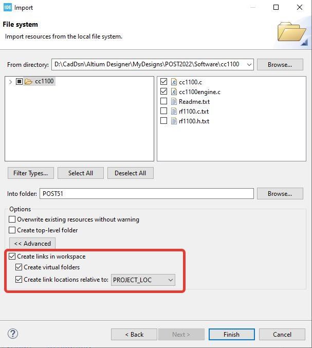

I add those files as in the pic:As a result this files now part of my project:
Compiling is OK. But when I start debug session any breakpoints settling inside are non functional for me. Can you try this for any of your projects? I use ST-LINK v2 (GDB server) connection.
