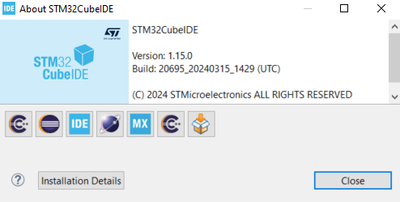

The last update of CubeIDE is like below:
I have this warning and I don't understand what it is:

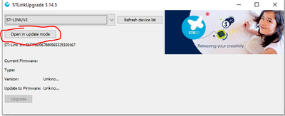

After this CubeIDE update, the FW update is required for ST_Link/V2 Programmer
I pressed the "Open in update mode" button.

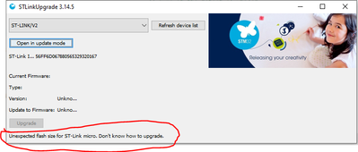

The error bellow is present now, like bellow:
What can I do to solve this aspect?
I can't use the programmer to program the micro controller or to make a FW debug.

2024-03-21 8:52 AM
Try to update your ST-Link FW with the STSW-LINK007 ST-Link firmware updater application.

2024-03-21 8:52 AM
2024-03-21 10:04 AM
Ok, it's working now. Thanks
