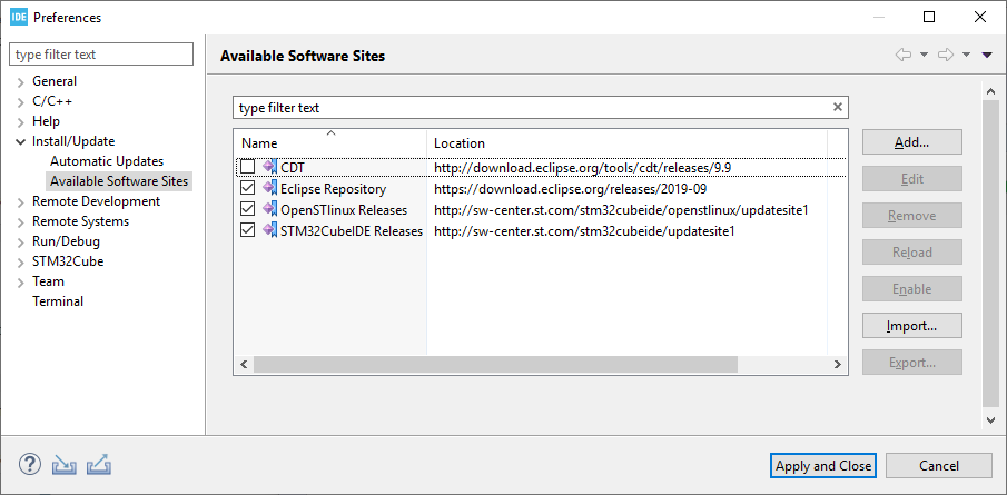

Looks related to the recent issue with the software site repository.
Could you remove the local software updater cache by deleting those 2 directories from your STM32CubeIDE installation:
STM32CubeIDE\p2\org.eclipse.equinox.p2.core\cache
STM32CubeIDE\p2\org.eclipse.equinox.p2.repository\cache
Make sure that the Software Sites URLs are well those by default:
And try to update again (Help > Check for update)
