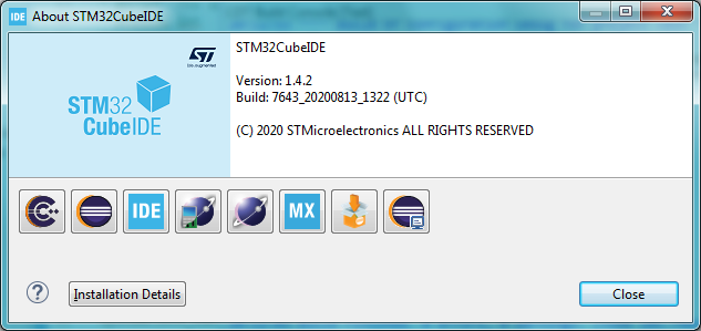

Using STM32CubeIDE version 1.4.2 on a Windows 7 64-Bit Home Premium Edition, Version 6.1 (Build 7600) laptop, I am unable to program and debug a project on a NUCLEO-F401RE board.

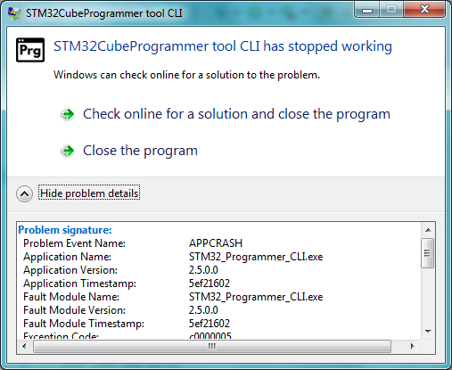

When I attempt to debug to program the board and debug and run the firmware, I get an error dialog "STM32CubeProgrammer tool CLI has stopped working" and am unable to continue.
The full details from that dialog window are shown below:
Problem signature:
Problem Event Name: APPCRASH
Application Name: STM32_Programmer_CLI.exe
Application Version: 2.5.0.0
Application Timestamp: 5ef21602
Fault Module Name: STM32_Programmer_CLI.exe
Fault Module Version: 2.5.0.0
Fault Module Timestamp: 5ef21602
Exception Code: c0000005
Exception Offset: 000cd5ce
OS Version: 6.1.7600.2.0.0.768.3
Locale ID: 1033
Additional Information 1: 0a9e
Additional Information 2: 0a9e372d3b4ad19135b953a78882e789
Additional Information 3: 0a9e

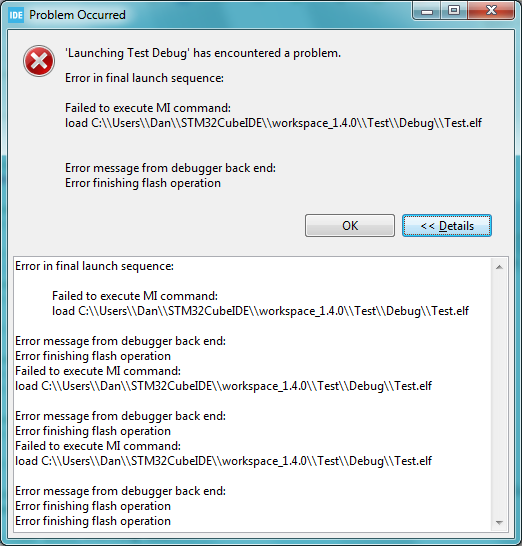

Additional Information 4: 0a9e372d3b4ad19135b953a78882e789When closing that error dialog I get the following error dialog from STM32CubeIDE:
Then in the STM32CubeIDE console was reported:
Encountered Error when opening
