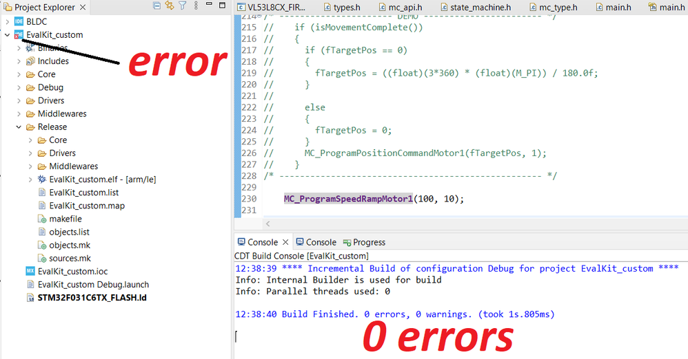

The problem that I have is that Project Explorer in STM32CubeIDE shows error symbol on the name of the project that I have but the when building the project, console window shows 0 errors. However I have ran the .elf file on Hardware without problems but I still worry about this error symbol.

I suggest you just to click on the name and select the option clean to clean your project. After that, rebuild your project. That should eliminate the error symbole.

@STTwo-32 Thank for reply. Unfortunately I have cleaned and rebuilt project many times but the issue not fixed.

If you are not using the V1.16.1. please update your CubeIDE. If so, please upload your project here.
