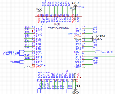

I have a STM32F405 and am trying to setup UART to connect to my pc. As of now I have connected it with an ST-Link/V2 and later on want to program it over USB-C using UART. See the wiring diagram:
I have used PA10 and PA9 for RX and TX.

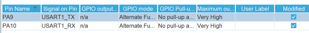

When it comes to the GPIO settings I have set the maximum output speed to "Very High" (not sure if this is correct).

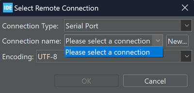

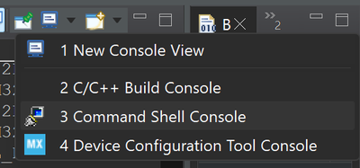

I have watched a guide on YouTube (https://youtu.be/dnfuNT1dPiM?t=4896) about how to getstarted in the STM32CubeIDE and stopped on the part about the "Command Shell Console":
At "Connection name" I had none and preesed "New..."

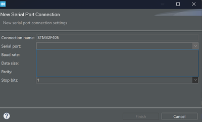

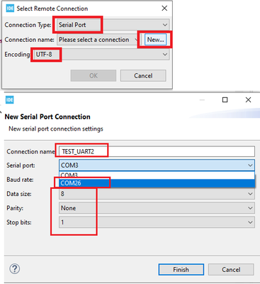

Now on the "Serial port", I dont know what to do. See image:
I am using a Windows 11 computer and heard something about using Tera Term or Putty, but I dont know how.
Can someone explain some more about the Serial port setting?

" I have set the maximum output speed to "Very High""
Not optimum but it works. I suggest Low to set them to low instead of very high.
Now regarding the config of the Hyperterminal:
You need to check what is the Comport number assigned by windows on your computer. You need to go to Device manager on your computer and go to Ports (COM & LPT) list:
This is what I found as comport number : COM26. You can find another number. This is what you need to put in Serial port in the CubeIDE console:
Hope I answered your question.

Thank you for your reply @mƎALLEm .
I will set the Maximum output speed to low then.

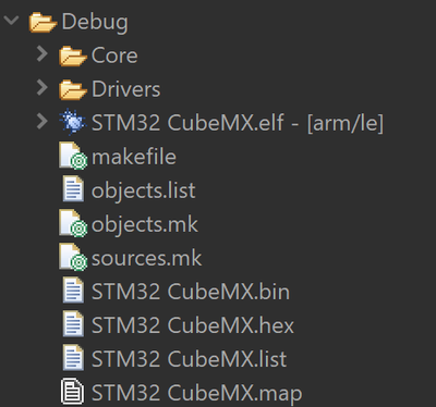

I have tried using the .bin file which is located in the "Debug" folder when I generated my code.
Do you have any tips regarding this?
Thank you!

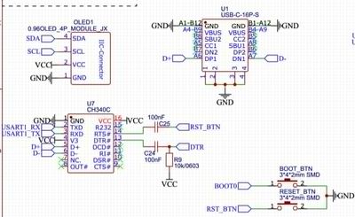

I have a custom PCB. I use a USB-C to USB-C cable to the STM32F4. I cant seem to recall I have a USB CDC Device firmware on it. Can I do this in STM32CubeIDE?
I can try to explain my setup somewhat better. The STM32F4 is power not powered by the USB-C, it uses another source on the PCB. The pins PA9(TX) and PA10(RX) go to the serial chip (CH340C). See wiring diagram:
From the serial chip (CH340C) pin D+ and D- are connected to the USB-C port. See wiring diagram:
RX/TX are correct from the STM32, such that RX goes to TX on the serial chip and TX goes to RX.
Hope this helps understand the problem.

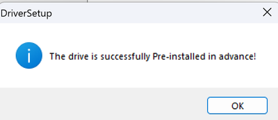

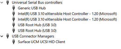

2024-04-24 4:10 AM
I have now installed the driver for the the CH340C and should be working.
I however do not see the Com port in the Device Manager.
Do I need to enable UART somewhere in the STM32IDE program?
Thank you.
