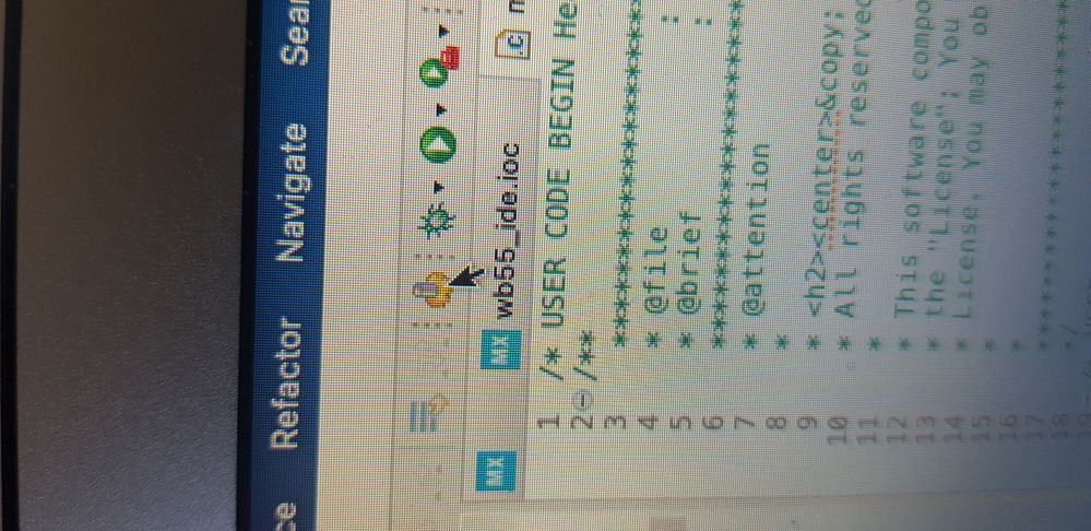

Sorry for the confusion! I am talking about the cudeIDE and not the MX. I am talking about the tools such as the following:When I hover cursor over them, on my windows machine, I get the name of the tool so its clear what it does. However, on my macos, when I hover over any of them , occasionally I will get the name but that is not always the case, I cannot figure out why it is so unreliable. Could you confirm whether you can hover over them all one by one and get the tool name displayed?
See the following image: I have hovered the cursor over something, and nothing pops up

No worries, I just wanted to make sure that I was testing the correct thing.
I wasn't able to reproduce on Catalina but using a Big Sur I get the same behavior as you do.
I don't know of any workaround but I have written a ticket (internal BZ#109234) so we can hopefully address this in a future release.
Thanks for bringing it to my attention!

A small update:
So far it seems as if this issue only occurs if the user has opened the ioc-file. Opening the ioc-file --> CubeIDE loads the CubeMX plug-ins. After this is done the tooltips are no longer reliable. A restart of CubeIDE will again lead to working tooltips. But only until next time the user opens the ioc-file.
Not so easy to further track down. Even though annoying, we see this as a low prio issue for now.
