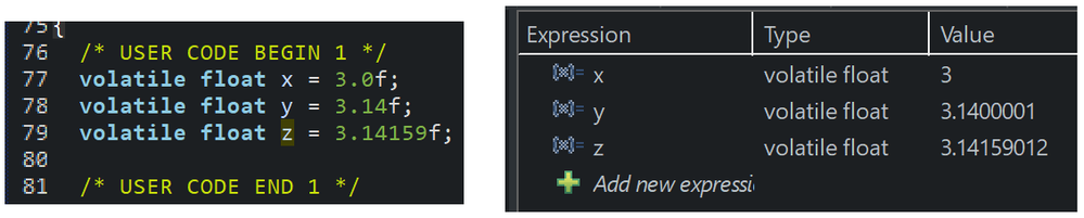

I'm debugging code with floats. I am using live expressions to watch the values, but even though I choose the decimal format I am not getting the decimal places for float values. I seem to remember doing this in another project and getting the decimal places.
Are there any settings you need to configure to get the thing to display floats correctly or doesn't the IDE do this?

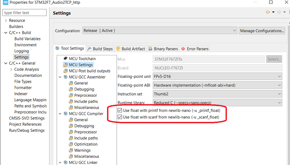

There's a setting under properties / C/C++ Build / Settings / Tool Settings / MCU Settings

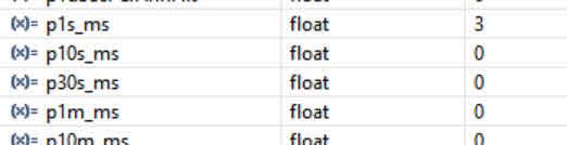

It doesn't display trailing zeroes after the decimal point. "3" is certainly a valid value for a float, as is "0".

I saw those settings, but there names are quite cryptic. I thought they had something to do with how code was compiled, not the actual IDE.

The problem with that is that the value was 3.873... not 3.0 the decimal paces were ignored. I was sure that I had decimal places in other projects.

Those settings do have to do with how the code is compiled.
I can't reproduce what you're seeing here (with checkboxes unmarked).
2021-11-29 3:42 PM
Setting the checkboxes fixes the problem, but at times the IDE still insists on displaying without the floating point representation. Then suddenly it comes good when your back is turned.
