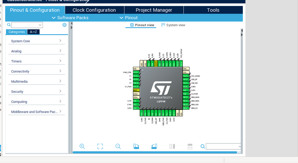

However, if I run the GUI as Wayland it is unusable -
After 45 minutes it get this far
Just the image of the device. No controls are active.

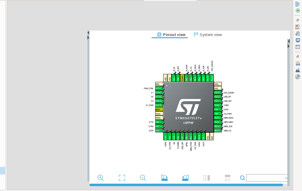

After 2 hours 30 minutes I get -
None of the controls are active yet.

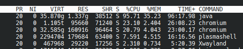

All this time Java, and its chrom'ies, are going flatout -
All my CPU cores are max'ed out. Temperature has max'ed out. The fan sounds like my laptop is going to morph into a hoover craft and take off...
I had to shut it down... The noise was interfering with some quiet time I had planned.
