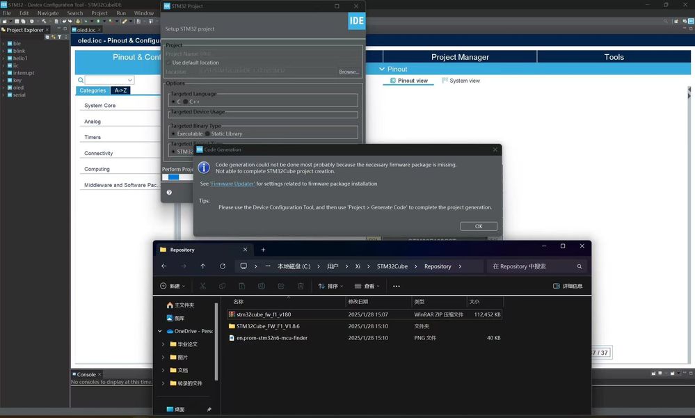

The problem is most likely due to the non-ASCII characters you are using in the path.
To test and confirm this, you do not need to reinstall the firmware, but can:

In which path did you install the IDE?
2025-01-30 2:06 AM
I first downloaded the IDE from the official website(st.com) on January 16th, and was able to use it normally for study and writing purposes within the following week.
E:ST/STM32CubeIDE_1.17.0

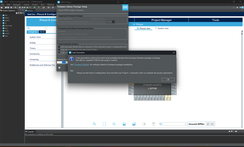

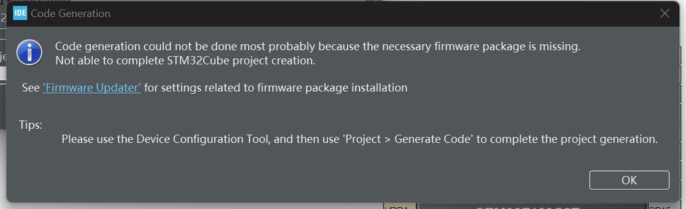

I apologize for taking such a long time to respond to you. Since the issue arose, I have tried numerous methods, such as clearing the CubeMX cache and restarting, checking that the MCU model and firmware version of the project match, manually specifying the firmware package path, verifying filesystem permissions, manually downloading and importing the firmware package, and reinstalling the software. I am using an STM32F103C8T6 with the firmware library STM32Cube_FW_F1_V1.8.6. Thank you for your continuous assistance and suggestions; I will keep waiting for your reply.
