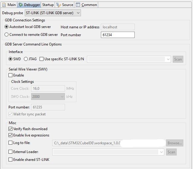

My last tests with SEGGER J-Link didn't include the speed settings.
I also tried with the same three initialization commands (yes, I had initially picked the wrong addresses which came from some old debug config setup that I had)
set *0xe000ed08 = 0x08020000
set $sp = *(unsigned int*)0x08020000
set $pc = *(unsigned int*)0x08020004
Yes, I selected ST-Link as debug probe:
