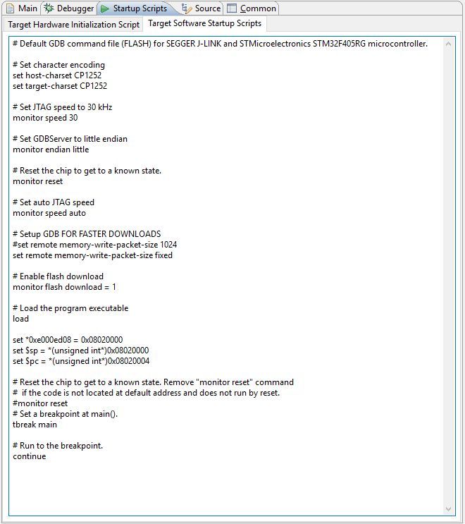

I used the following "Target Software Startup Script" in the debug configuration in Atollic TrueStudio (this is necessary since we're using a bootloader and our application binary which I would like to debug is not placed at the beginning of the STM32 flash):
How to enter this in STM32CubeIDE?
I would really need to debug my firmware, but can't figure out how to do the required settings...
Any ideas?

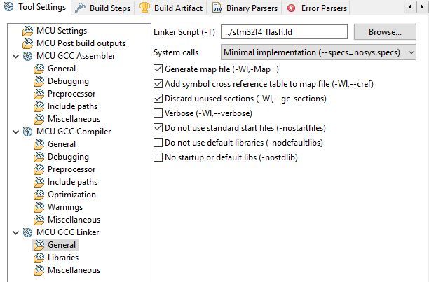

2019-06-21 1:38 AM
I just solved the issue...
It turned out that the linker setting "-Wl,--cref" (Add symbol cross reference table to map file) was missing. Checking the corresponding box in the linker settings, debugging now also works also with ST-Link in CubeIDE!

2019-06-06 6:05 AM
When I use e.g.
x Load image
Use project binary
x Load symbols
Use project binary
and under "Run commands":
set *0xe000ed08 = 0xC000
set $sp = *(unsigned int*)0xC000
set $pc = *(unsigned int*)0xC004
set *0xE0042004 = (*0xE0042004) | 0x7
tbreak main
continue
the binary is flashed correctly to the MCU, but then the (ST-Link V2) debugger connection is lost:
Download verified successfully
Error! Failed to read target status
Debugger connection lost.
Shutting down...
Any ideas?
Kind regards,
Markus

2019-06-11 12:40 AM
It seems setting stack pointer and program counter makes problems:
Failed to execute MI command:
Error message from debugger back end:
Selected thread is running.
So my question is how I can make these settings with the STM32CubeIDE dialog.
Kind regards,
Markus
