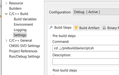

What ended up working for me: (im using windows STMCUBE IDE 1.5.1)
I struggled with the directories, aparently the build directory is the folder /Debug or /Release but i want to place my script in root project directory so i cd ..;
cd ..;./prebuildJaviscript.sh

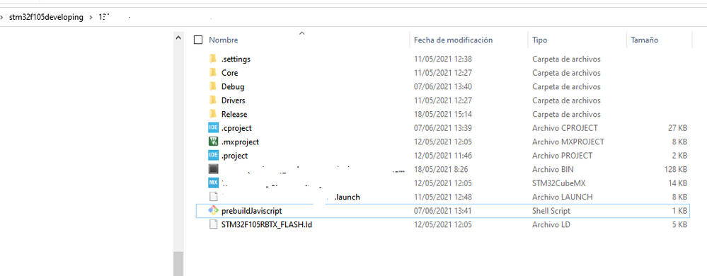

The script was placed here:
Containing;

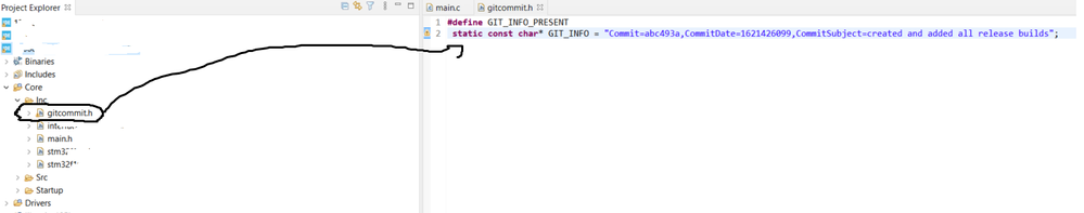

git log --pretty=format:'#define GIT_INFO_PRESENT%n static const char* GIT_INFO = "Commit=%h,CommitDate=%at,CommitSubject=%s";' -n 1 > Core/Inc/gitcommit.hAnd the cript creates this:

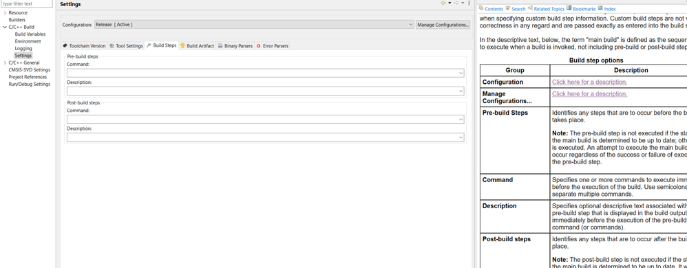

Right click project -> Properties -> C/C++ Build -> Settings -> Build Steps.

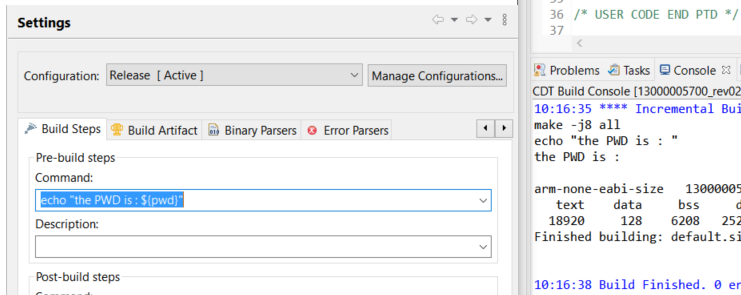

That sounds fantastic @Pavel A. ! Im very new in this area, so what is Command expecting from me?
In what languaje should i write the socalled "commands"? shell script?
if i add ./myscript.sh it doesnt find my script and i have no idea where is looking for it.
If i add echo "the PWD is : ${pwd}"
Containing;
