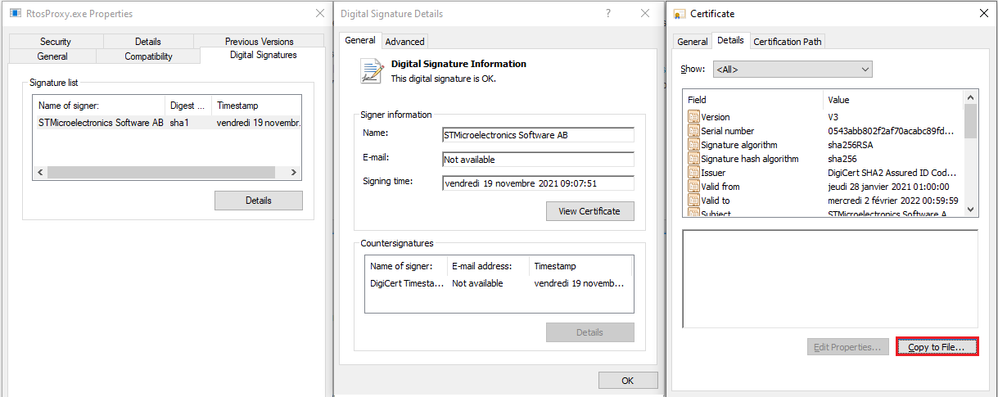

Hi @HNguy.18,
If the authenticity of RtosProxy.exe can be verified then you can use it safely, it's not a malware at all.
The authenticity can be ensured by checking the digital signature:
Certificate (base-64 encoded):

This is a utility executed during the Debug flow to enable some RTOS useful features.
Hope this helps
