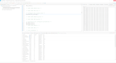

A simple program created using FreeRTOS and Configuration: SYS > Debug: Trace Async Sw.
FreeRTOS running a single task. The task prints out a line every 1 ms.
The single task has the following loop:
for (int32_t i = 0;; ++i)
TaskDelay(1);
printf("%ld DEBUG printf hang: SWV ITM Data Console buffer overflow.\n", i);
Start Debug, the SWV console prints out text and works for a while, then the IDE hangs. See screenshot below:
IDE hangs and not responding. Force close IDE and restart it. Try to try debug again and get the following error:
Disconnect and reconnect the evaluation board, run debug again, get the following error:

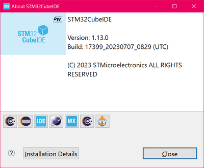

IDE version:
so you can read 1000 lines per sec. ??
well , IDE/java cannot write 1000 lines/s . :) some internal buffer flooded...
try same, but delay 1000 . 1 sec. this about the update rate in the IDE , afaik.

Hello @Garland and welcome to the community,
I have tried to reproduce this issue using FreeRTOS and Configuration: SYS > Debug: Trace Async Sw on STM32CubeIDE 1.13.0 version. Everything is working correctly with the created task that prints out a line every 1 ms, but you have to increase the trace buffer size (window => Preferences => STM32Cube =>Serial Wire Viewer) before getting full.
