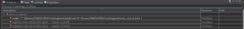

Downloaded the STM32F10x standard peripheral library.
But there is a problem.

Hello @sHong.1 ,
You can make a search on the web and have a look at this site cesareriva.com which describing the fix of core_cm3.c.
Otherwise, we need more details to help you solve your issue.
