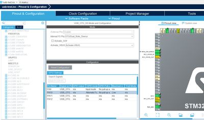

I am using stm32cubeIDE to use USB OTG/Dual_role but it does not generate the middleware!
I do appreciate any help

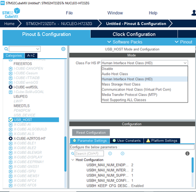

Hello @MIman.1
Have you enabled any middleware on your CubeMX configuration. Enabling the USB OTG/Dual_role does not select any Middleware by default.
Can you give more clarifications about your configurations.

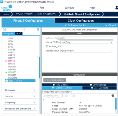

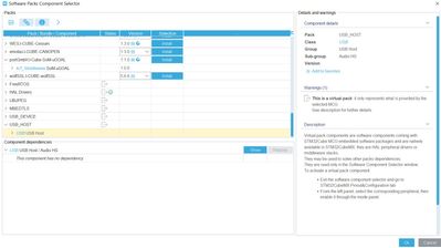

2024-02-13 9:43 AM

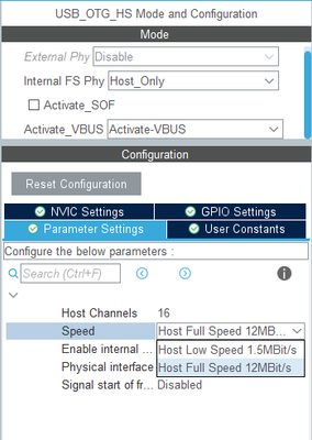

It does not let me to install the USB packages. is there any istruction on how to install it. thanks again
2024-02-13 11:24 AM
You don't have to install it since it is a virtual pack that only represents what is provided by the selected MCU. You just have to select the mode Host only for the internal FS Phy of the USB_OTG_HS mode.

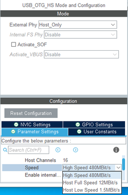

2024-02-13 1:33 PM
Thanks a lot! It worked really well for transmitting and receiving data via device only.
One last question: I am limited to use 12 MBit/s with this config. As I see in the data sheet I should be able to use High speed upto 480 Mbit/sec.
I do appreciate if you make some comments on that too.
best
2024-02-13 2:24 PM
Infact, the Nucleo board support only the USB OTG FS as mentionned on the DB3171. So, you can only configure the internal FS Phy which support only low speed and full speed (max 12MBits/s):
But, when using the STM32H723ZGT6 MCU, you can use the External Phy which can go to High speed (480 MBits/s). But you have to connect an external PHY device to the ULPI (which is not done on the nucleo board) as mentionned in the paragraph 3.43 of the DS13313:
