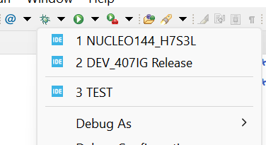

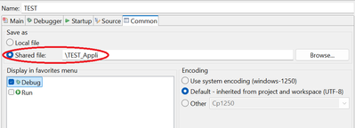

2025-02-10 12:48 PM - edited 2025-02-10 1:00 PM
Did you set shared file for your config? this file can be backuped.
It is also good to set display in favorities.
Check:
workspace .. \.metadata\.plugins\org.eclipse.debug.core\.launches for any *.lauch files
edit 2.
Your debug config should be visible
Not that as You try on
(here debug config are invisible for me also).
