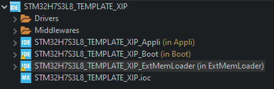

"Project Explorer":
The project names "Boot" and "ExtMemLoader" have little warning signs on the icons. What do those mean?

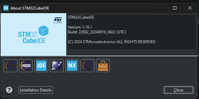

The STM32CubeIDE version I'm using is the latest:

I still don't know what those warning signs on the project icons for the Boot and ExtMemLoader projects mean.
