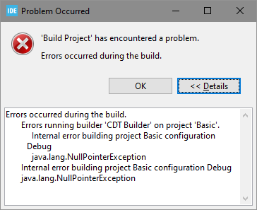

In the "bad" workspace choosing the "internal" builder and trying to build a project, a severe error occures:
Errors occurred during the build.
Errors running builder 'CDT Builder' on project 'Basic'.
Internal error building project Basic configuration Debug
java.lang.NullPointerException
So, I think, the problem is not in the console but in the fact, that the internal builder is invoked to build a single file, it crashes, and the console has nothing to show!

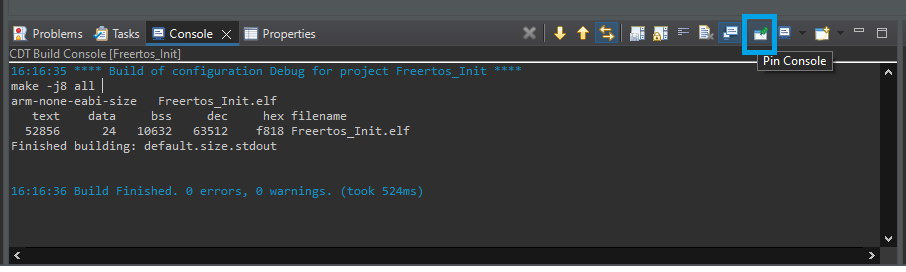

About the second question I think that you accidently clicked on "Pin Console".
Check if the button shown in the screenshot is not pressed on any console in your workspace.

In the "good" workspace it does not matter, pinned or not: I see the output of the builder anyway. The main issue is no more the console but the fact, under the "bad" workspace the internal builder crashes:
Later, since for building of a single file always the internal builder seems to be engaged, it crashes silently, and the console shows nothing...
