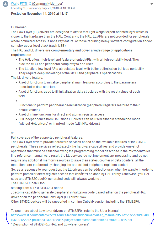

HAL is written in C, C is a languaje, HAL stands for hardware abstraction layer and its just a bunch of libraries provided by ST.
They are not perfect, not everyone uses them, if you do use them,handle with care and schepticism, i do use them.
>> but not using HAL, just plain C
Why you dont want to use it?, i get from the question youre just getting started with stm32.
Your options(from lowerest level to highest):
>>Where do I find the appropriate libraries, headers and documentation?
Of which one

>>where I can find the documentation for the C-API, be it LL
>>OTOH, even if I would be using HAL, where do I find the documentation, the #defines and available functions etc.?
you didnt clicked in any of the links i sent didnt you XD.
basically you go to your specific chip reference manual
>>And how do I switch off HAL
as they are just libraries, delete the corresponding ....hal.....h include, or if they are still giving you trouble remove the folder from the project path.
