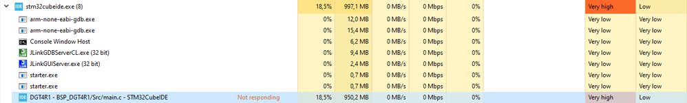

I just open a workspace that used to work fine. Just let it sit there, doing nothing. The option Project->Build Automatically is disabled. Tried and disabled Indexer, but to no avail!
Some weird Build Project thread gets started, which never ends and prevents any other operation. Even trying to edit a source file is stopped, due to this mysterious "build" in progress. You get the message "The user operation is waiting for background work to complete."
After a while the IDE stops responding altogether, the load on the CPU is Very high, and the only possible thing to do is terminating it from the Task Manager.

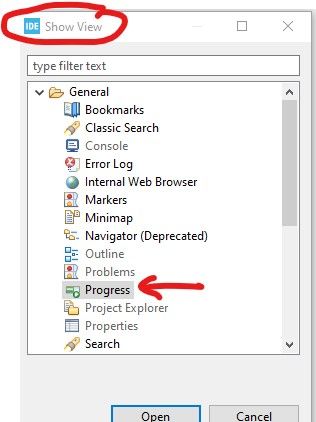

@Osto sounds you're facing performance issue if embedded MX usage. Here @GC.Selene is reporting build time issue I'm not sure both issues are related.
@GC.Selene is your workspace include a single project or multiple ones ? If multiple ones are all STM32CubeIDE projects or a mix of some other nature ?

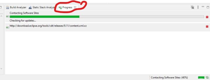

Then CPU running high any info as part of Progress view (Windows > Show View)?

Also progress window shows nothing.

Nothing happens in Progress. It happen in system with one project and also multiple project in the same workspace.

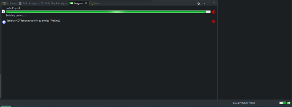

I have been able to work OK for a few weeks. Now, for some mysterious reason, the problem has appeared again.
I had the "Debug Configurations" dialog open, but when I tried to press the "Debug" button the IDE got unresponsive.
I noticed the dreaded "Build Project" stuck at 98% (see image attached).
I had to kill the IDE from the task manager, but I had already changed the log "Threshold" to "DEBUG". I attach the log files too.
