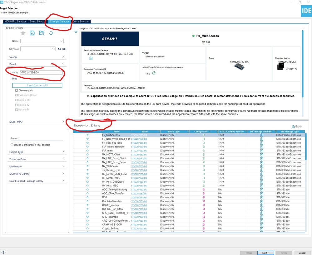

File > Import > Import STM32Cube Examples

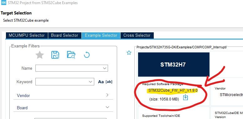

You're claiming already on your hard drive but is it expected pack version ? ... if not IDE is expecting to download it so network access requirement.

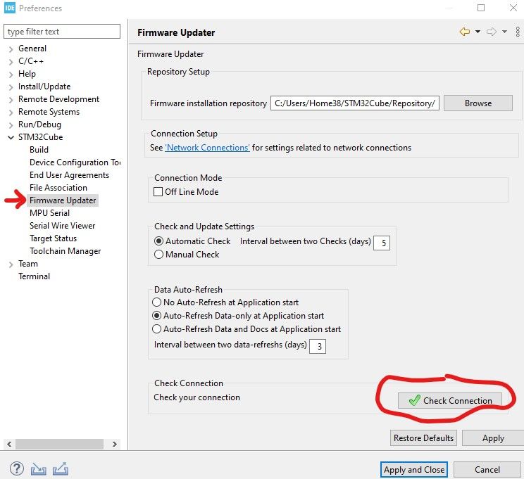

Are you able to get green chek if connection check ?

No, I was never able to get the green check no matter what I did. That's a good workaround you suggested. Thanks.

Not having access to remote is a pain.
Still solution to retrieve and install by yourself required pack but not so nice vs. one click solution.
If doing handmade, pick pack from www.st.com then rely on "From Local" based on Help > Manage Embedded Software Packages
