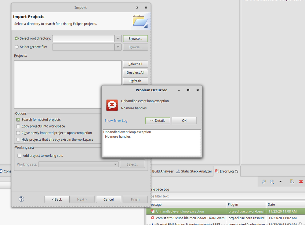

I cannot import existing project into Workspace. Here's the error log when I try to select a root directory:
eclipse.buildId=Version 1.5.0
java.version=1.8.0_272
java.vendor=AdoptOpenJDK
BootLoader constants: OS=linux, ARCH=x86_64, WS=gtk, NL=en_US
Command-line arguments: -os linux -ws gtk -arch x86_64
org.eclipse.ui.workbench
Error
Mon Nov 23 11:08:37 CET 2020
Unhandled event loop exception
org.eclipse.swt.SWTError: No more handles

Any hints?

2020-11-23 3:56 AM
Is this for any directory you choose or a specific one?
What version of Linux are you using?
2020-11-23 4:06 AM
Is this for any directory. Just after clicking the "Browse..." buttom
I've used the previous version 1.4.0 with no problems on my Linux Mint 18.3 64-bit
gaston

2020-12-01 7:40 AM
Hi Markus,
I've finally update my GTK+ version from v3.18 to v3.20. Now it works as expected.
Thank you for all anyway,
