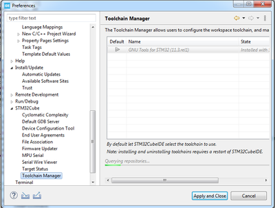

As posted countless times: this is because cube 1.15 upgrades the GCC tools from v11 to v12.
You can revert the tools back to v11 here
Or uninstall cube and install 1.14.1 which is still on the ST website (for not much longer so grab it quick!)

it doesn't work for me((
2024-04-03 7:35 AM
Only your advice helped, thank you!!!
