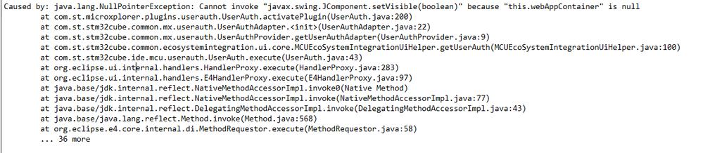

2023-07-18 8:29 AM - edited 2023-07-18 8:51 AM
I've now tried uninstalling and reinstalling and I'm faced with the same issue. Below is what happens when I hit "manage embedded software" from the Eclipse log file:

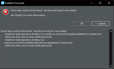

When I hit "Check for Updates" I get the following:
