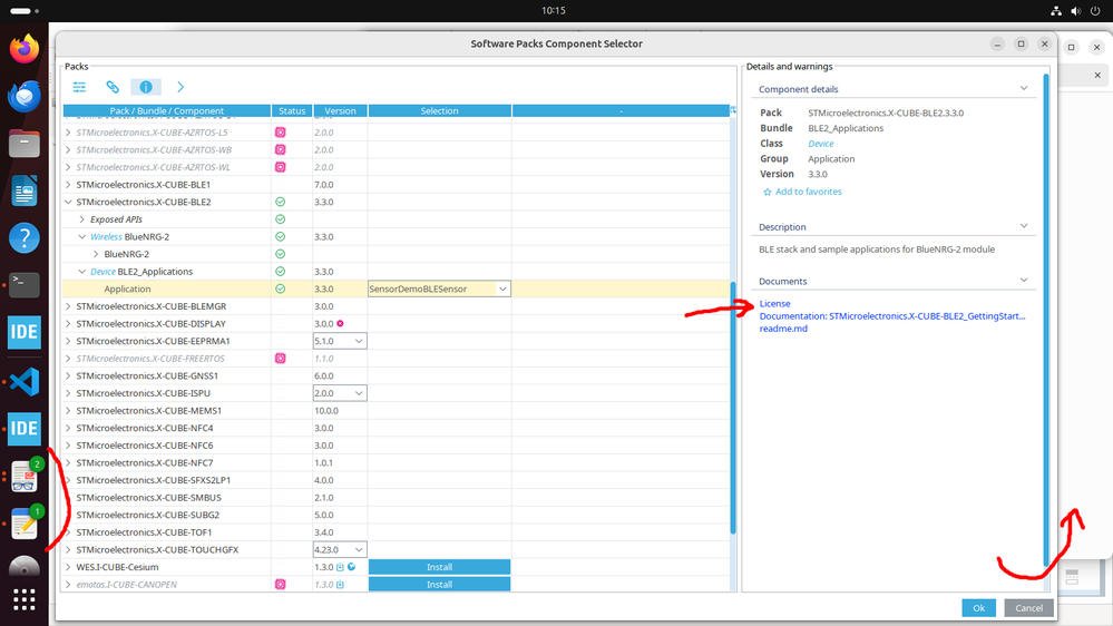

When I view the information panel after selecting the "X-CUBE-BLE2" -> "Device BLE2_Applications" -> "Application" -> "SensorDemoBLE..." and clicking on the "Documentation: STMicroelectronics X-CUBE-BLE2_GettingStarted..." link, the "Software Packs Component Selector" popup window hangs and cannot be closed. The document is never displayed.
From what I can tell, it is attempting to load "/home/me/STM32Cube/Repository/Packs/STMicroelectronics/X-CUBE-BLE2/3.3.0/Documentation/STMicroelectronics.X-CUBE-BLE2_GettingStarted.pdf".
I ran the IDE software updates via the "Help" menu yesterday, so I assume it is the latest version. The command line shows it is running "/opt/st/stm32cubeide_1.12.0//plugins/com.st.stm32cube.ide.jre.linux64_3.1.0.202310310920/jre/bin/java" with "-Dosgi.instance.area.default=@user.home/STM32CubeIDE/workspace_1.14.1 -Declipse.buildId=Version 1.14.1"

It appears the java AWT Event thread is hung. The stack trace is:
"AWT-EventQueue-0" #78 prio=6 os_prio=0 cpu=72358.73ms elapsed=88480.05s tid=0x00007fa7606a6a40 nid=0xee82 runnable [0x00007fa7da5ed000]
java.lang.Thread.State: RUNNABLE
at sun.awt.X11.XDesktopPeer.gnome_url_show(java.desktop@17.0.8.1/Native Method)
at sun.awt.X11.XDesktopPeer.launch(java.desktop@17.0.8.1/XDesktopPeer.java:119)
at sun.awt.X11.XDesktopPeer.browse(java.desktop@17.0.8.1/XDesktopPeer.java:108)
at java.awt.Desktop.browse(java.desktop@17.0.8.1/Desktop.java:533)
at com.st.microxplorer.plugins.thirdparty.gui.view.DetailsWarningPanel$CustomLinkModelAction.actionPerformed(DetailsWarningPanel.java:135)
at javax.swing.AbstractButton.fireActionPerformed(java.desktop@17.0.8.1/AbstractButton.java:1972)
at org.jdesktop.swingx.JXHyperlink.fireActionPerformed(JXHyperlink.java:266)
at java.awt.EventDispatchThread.pumpEvents(java.desktop@17.0.8.1/EventDispatchThread.java:109)
at java.awt.EventDispatchThread.pumpEvents(java.desktop@17.0.8.1/EventDispatchThread.java:101)
at java.awt.EventDispatchThread.run(java.desktop@17.0.8.1/EventDispatchThread.java:90)
I have included the full thread dump in the attached "stack.txt"

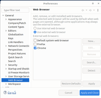

I think I've fixed the issue with the "Information Center" links not working.
I went to "Window" -> "Preferences" -> "General" -> "Web Browser" and changed it to "Use Internal web browser" and selected "Chrome", then clicked "Apply and Close".
Testing further it seems that "Firefox" and "Default system web browser" does not work, but "Chrome" does whether or not "Use internal web browser" or "Use external web browser" is selected.

About the X-CUBE-BLE2 documentation issue, I have a different behavior: when I click on any link from "Documents" section, it gets opened by either a text editor or a pdf viewer (as you can see in the apps menu bar on the left) but their respective contents are always hidden behind the "Software Packs Component Selector" window ! Then I just cannot read anything until I close this window or reduce its size... but no hang so far.

This also fixes the hanging issue I originally posted.

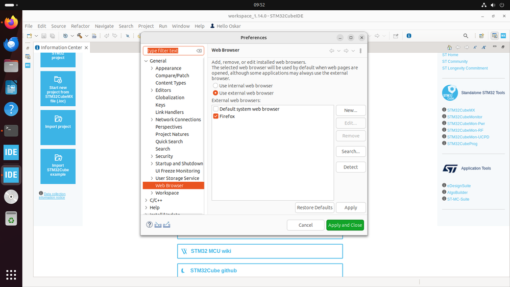

Helo @snacker ,
thanks for your advice but I have tried all combinations of Web Browser settings in Preferences > General and none of them work.
Note that I don't have Chrome installed on my system, only Firefox... But I expect it to be launched when choosing "Use external web browser" and either "Default system web browser" or "Firefox" !
I did not find any recommendation in STM32CubeIDE User Guide about these settings.
ST should definetely fix this !!

@Oskar_H , I did some more research on this. It appears that it (eclipse in general) only works with older versions of Firefox. You might want to try to install Chrome and see if that works (with Chrome selected in the settings).
