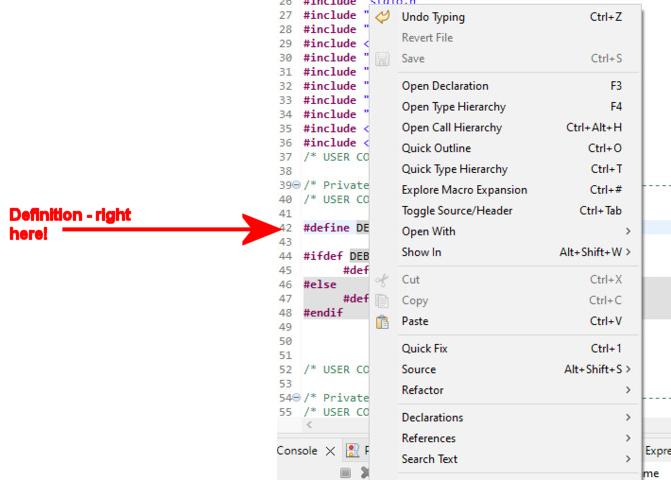

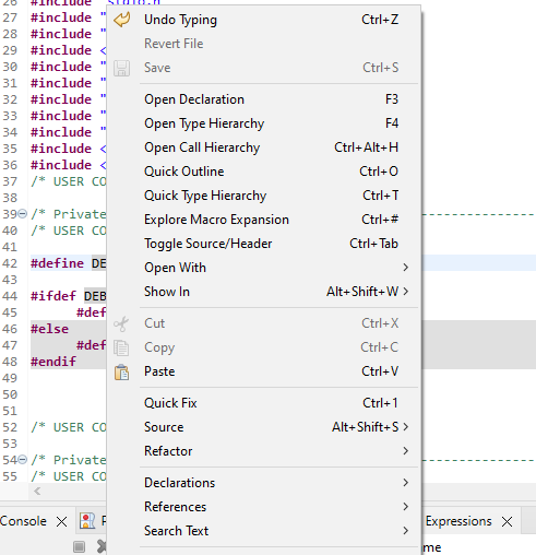

2022-05-25 4:26 AM
It wont let me go to definition. Clicking go to declaration doesnt go anywhere.
2022-05-25 4:26 AM

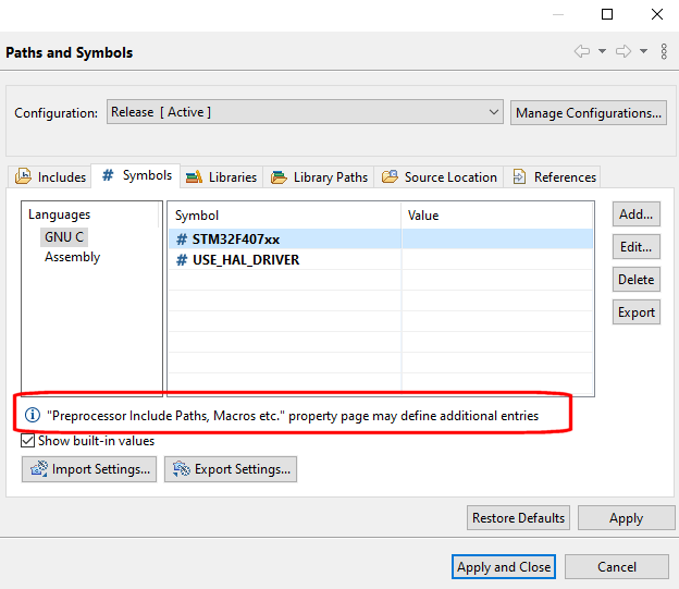

It should be simple - DEBUG should just be defined for the 'Debug' configuration in the Project settings.
But that fact that it's not working shows that something's gone wrong ...
If those prints are still appearing, DEBUG must be getting defined somewhere.
Or you're not loading the code you think you are.
have you checked that?

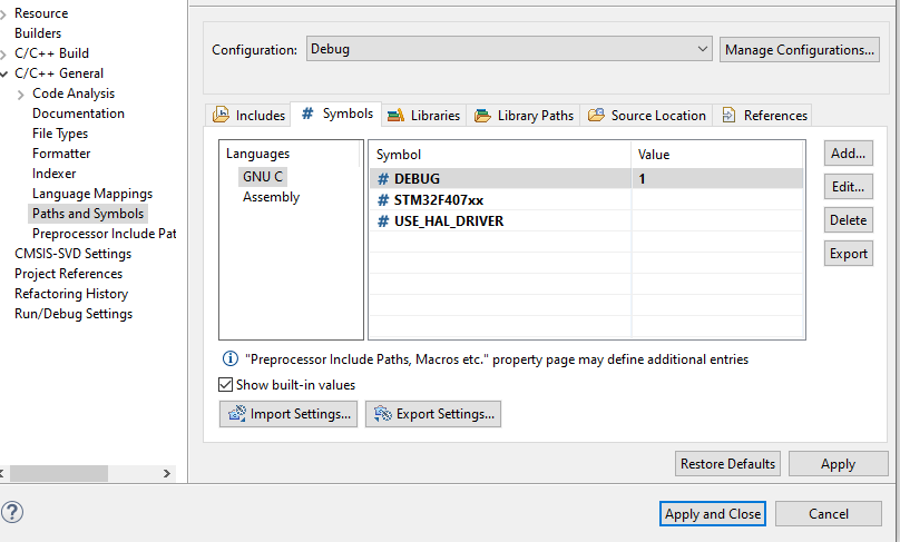

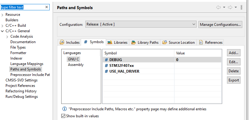

Ok I understand now. I did the following:
For release I define debug 0
For debug I define debug 1
Then in my main.c:
#if(DEBUG==1)
#define DEBUG_PRINT(X) printf X
#else
#endifNow the DEBUG_PRINT only works when I am in debug mode exactly how I want to!
Thank you very much for your help
