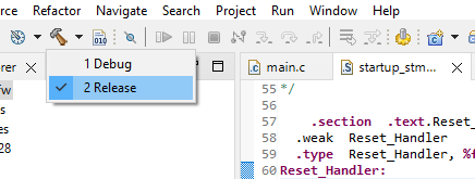

I have implemented the code that you have suggested, then I have built my project using release mode:
And then I just clicked "run"

"I have built my project using release mode"
I'm not sure if just changing Debug/Release will force a full rebuild?
To be sure, do a Clean first, and then rebuild.
Check the timestamps on the output files...

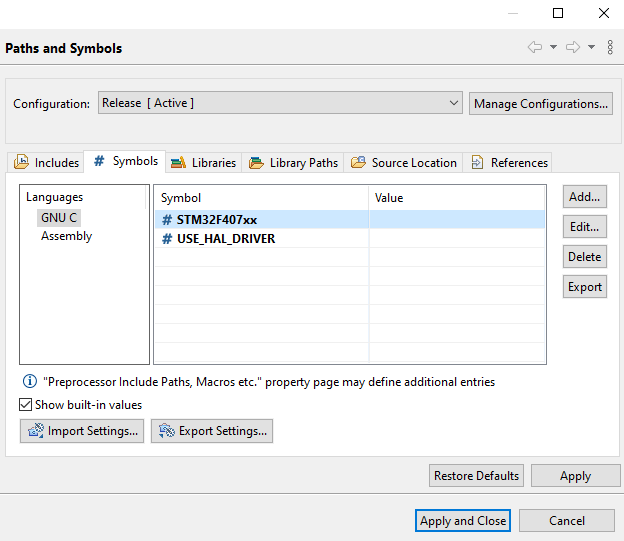

Do I need to add DEBUG symbol here?:
2022-05-25 3:22 AM
I have deleted all debug/release folders and did a fresh build so that should be fine..
2022-05-25 3:55 AM
That's showing the 'Release' configuration - so you want DEBUG to not be defined.
Which seems correct.
Note that there are separate settings for C, C++, and Assembler.
It's common to define NDEBUG as a complement to DEBUG - so you might add that here.
NDEBUG and DEBUG should be mutually exclusive - you could check with
#if defined( DEBUG ) && defined( NDEBUG )
#error "Both DEBUG & NDEBUG are defined"
#endif
2022-05-25 3:57 AM
If your prints are still printing, then it must be getting defined somewhere!
Do you get the shading correctly?
What happens if you do a 'Go to definition' on DEBUG ?
