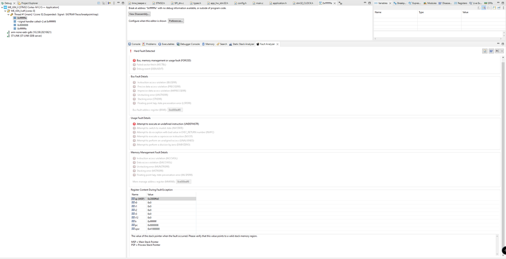

I'm running a fresh board on an STM32L431RCT6. I'm able to successfully run and debug a simple application that I created with STM Cube, but, when flashing our ported application (we have moved from Kinetis, due to the chip shortage), the stack frame looks like it jumped from 0xFFFF FFFE to 0x800 0008 to 0xFFFF FFF9 and then to 0x1FFF 3EEC. I've shorted PH3/BOOT0 pin to ground and checked the 0x800 0000 memory to make sure the first 8 bytes contain the top of the RAM and the address of the main function. They do.

I've looked at the SYSCFG register and it shows as booting from flash both for the simple test app (that works) and our ported application. The SCB->VTOR is my last go-to, that's probably the biggest difference. The simple app I'm testing with stores the interrupt vectors in flash, while ours does it in RAM.
Show.

2022-06-28 1:48 AM
So this is how the call stack looks along with the Fault Analyzer after the initial debugger run.
However, if I press the "Reset the chip and restart debug session", it correctly goes to the 'main' routine. The problem there is that it doesn't seem to be able to load the source files and I can't debug. This is odd because:
