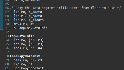

2024-09-25 4:26 AM
You need to both modify the linker script to store the values in flash, and you need to modify the startup code to copy those values from flash into DTCM. Here is where it happens for RAM. You'll need to add another section from DTCM, along with creating those symbols (_sdata, etc, but for DTCM) in the linker script.
