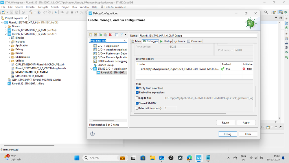

Thank you for your valuable responses. I resolved the issue by making some changes in the debugger configuration. Specifically, I added the QSPI loader file in the external loader option located at "PROJECT_LOC\..\gcc\QSPI_STM32H747I-Riverdi-MICRON_V2.stldr" After debugging it again, everything works well now. Please refer the below attachment.

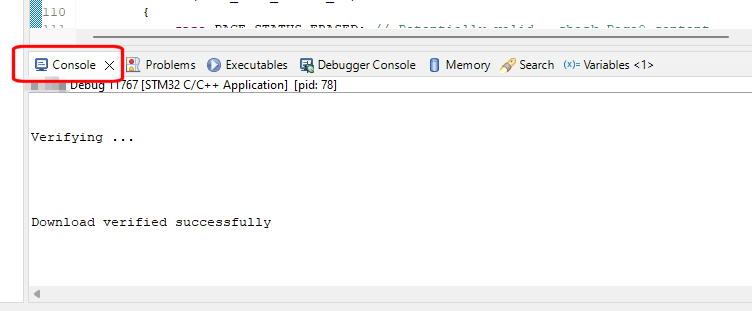

There should be more details in the 'Console' tab of the IDE:
Please go to the 'Console' tab, select all, copy, and then paste as text here.
