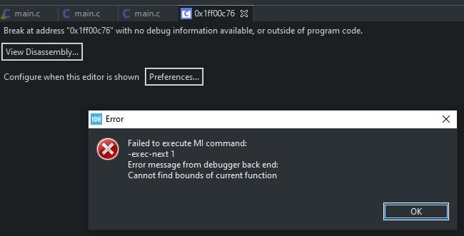

still no success but i'm trying to debug another board and it jump here
2022-06-20 10:06 AM
The 0x1ff0.... adresses belong to the system memory, i.e. the on-chip boot loader is exectued and not the normal flash boot. Check boot pins,... for the correct boot mode.

everything is setup normally but it still won't boot
