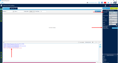

Afterwards, I converted J-Link into ST Link. But, I can not use ST Link driver. I can not connect to the board via ST Link. I get this error below. Could anyone help me with this please ?
I have connected the board directly to the USB port on PC, not via hub or deck.
I have checked that, ST-Link Debug is seen under device manager.

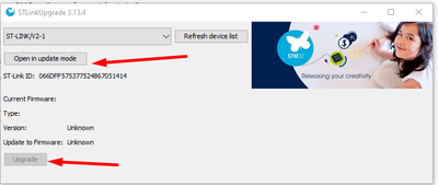

2024-03-03 6:03 AM
I have found out the solution and now it works again!
I think this is a common issue, so I hope the ones who encounter this problem will use this solution from onwards.
Unplug the usb cable from the PC, then plug it and immediately click on Help --> St Link upgrade -- > Open in Update Mode --> Upgrade.

Can you connect with STM32CubeProgrammer? Does the STLink show up? Does the target voltage show up?
2024-03-03 5:36 AM
I can not.

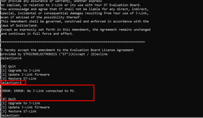

2024-03-03 5:48 AM
Thanks.
Yes, I rebooted but that didnt return things to normal. I have double checked unflashing of J-Link is successful or not, please see below image from STLinkReflash tool.
