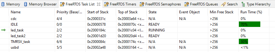

I'm currently trying to configure FreeRTOS task aware debugging. It mostly seems to be working, however, I cannot get the Min Free Stack, Event Objects or State columns fully working on the Task List Tab. The image below displays the current state. I want Min Free Stack to display Stack Usage and the Event object to not display nothing or N/A as per https://my.st.com/resource/en/user_manual/dm00629856-stm32cubeide-user-guide-stmicroelectronics.pdf

2021-08-01 11:43 PM
Upgrading to STM32CubeIDE 1.7.0 fixed the issue.
