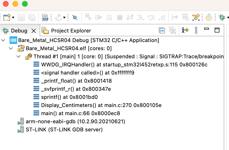

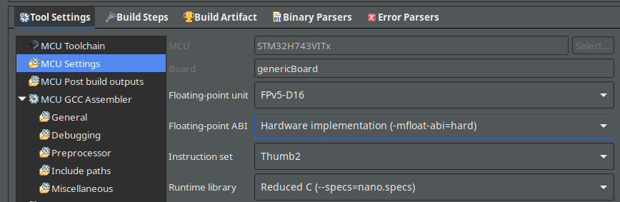

I am facing a similar problem. How did you enable the FPU in project?
in project setting...can choose hardware FPU, if possible on target cpu...

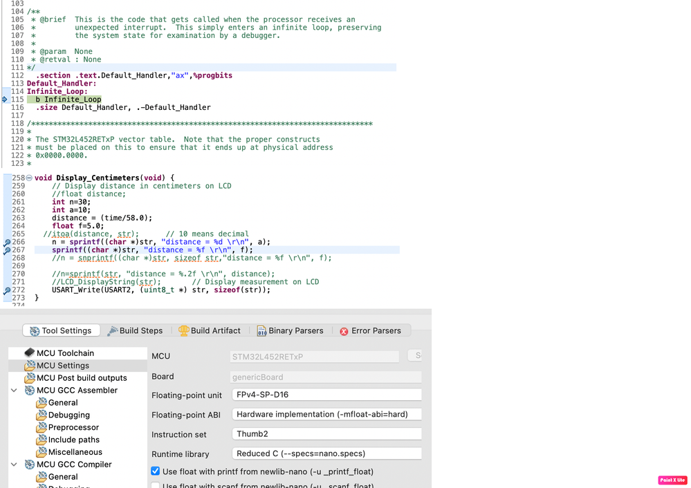

Although all settings are correct, sprintf doesn't work with floating point number only. Although it works on stm32cube, it doesn't work on bare-metal program. It loops endlessly in the Default_Handler function. I'm about to go crazy. what else can i do?
Are you sure this is consequence of a fault? It may be e.g. also incorrectly set interrupt vector table.
At any case, don't hijack others' thread. Instead, start your own, stating your hardware, used software, expected and observed behaviour. If you feel this thread is relevant to your problem, give a link to it.

FEvra.1
Associate II
How can i disable WWDG_IRQHandler?
