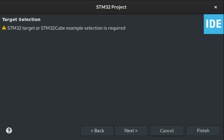

Copyright (c) 2021 STMicroelectronics. All rights reservedHowever, I am not able to create a new project.
I get the following error. I never had to install anything separately before.

2021-08-16 3:37 AM
Hello there!
Does MCUFinder start for you at all when you try to create a new project? The window during the project creation process where you select a target?
From the looks of it, it appears that MCUFinder is never launched.
I don't think I have a fedora 34 to test on. I will see if I can update one of the computers in the office to try this on.
2021-08-16 8:32 AM
No, the MCU finder is not launched at all.
Please do, that would be really helpful.
2021-08-16 9:30 AM
Same issue here with Fedora 33. Stuck on this screen and can't make a project
2021-08-17 12:46 AM

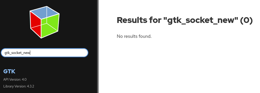

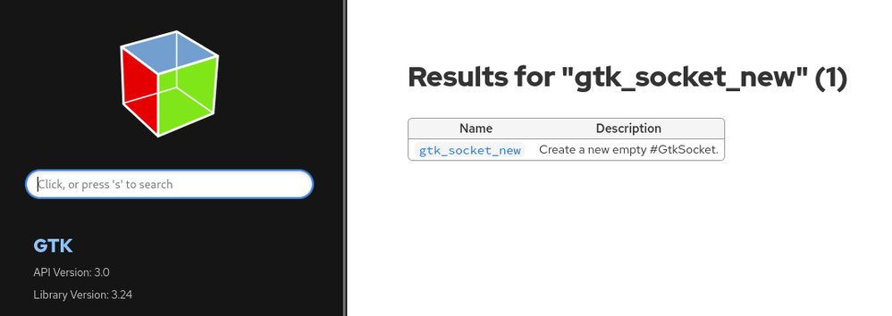

I doubt it because the issue is upstream. It stems from this ticket.
2021-08-17 6:32 AM
The gtk_socket_new function does not seem to exist in GTK4, what could you make of that?
Also Bug 721224 referenced in it says:
"Firefox uses X11 (via Xwayland) even under Wayland, meaning NPAPI can still work. AFAIK NPAPI can't ever work without X11 since it uses native X11 types as the API."
So is that a possible work-around?
