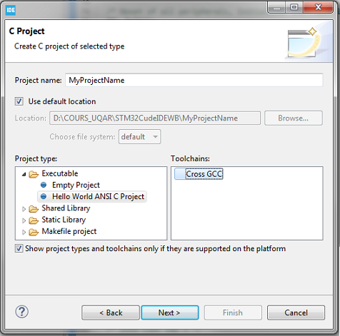

Do you want the compiled program to run on the PC? I don't know if it works or whether STM32CubeMX can do it at all but you might try:
Install a gcc compiler for your platform first (Cygwin or mingw on Windows).
When selecting the project type, uncheck Show project types and toolchains... at the bottom.

Your question is not very clear what you want achive. I have attached a screen shot with a window for project creation. CubeIDE should be able to build anything because it is Eclipse . You need to have the right software installed and it looks like you can build even PC applications unless it is somehow blocked.
