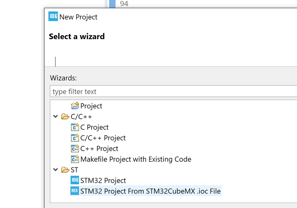

Building in: E:\Blink_G474RE\build\default
make -f ..\..\Makefile
Error: build command 'make' not foundError:
What's wrong with it ?
Should I set the gcc environment variable manually?
I have heard gcc is the default build tool for CubeIDE, is there something I misunderstand ?

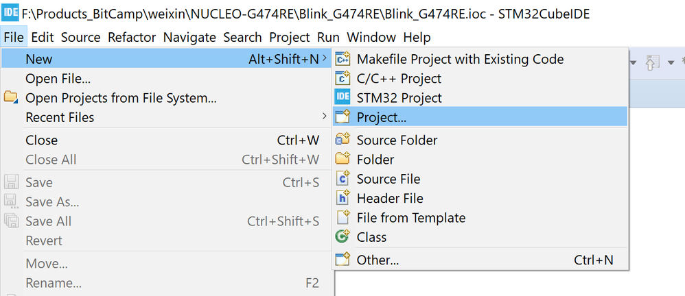

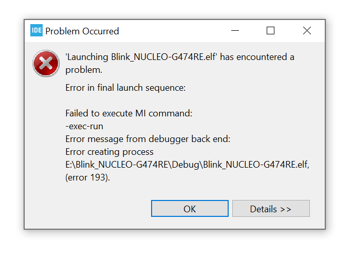

When I clicked this button,
this error prompted.
How to fix it?
