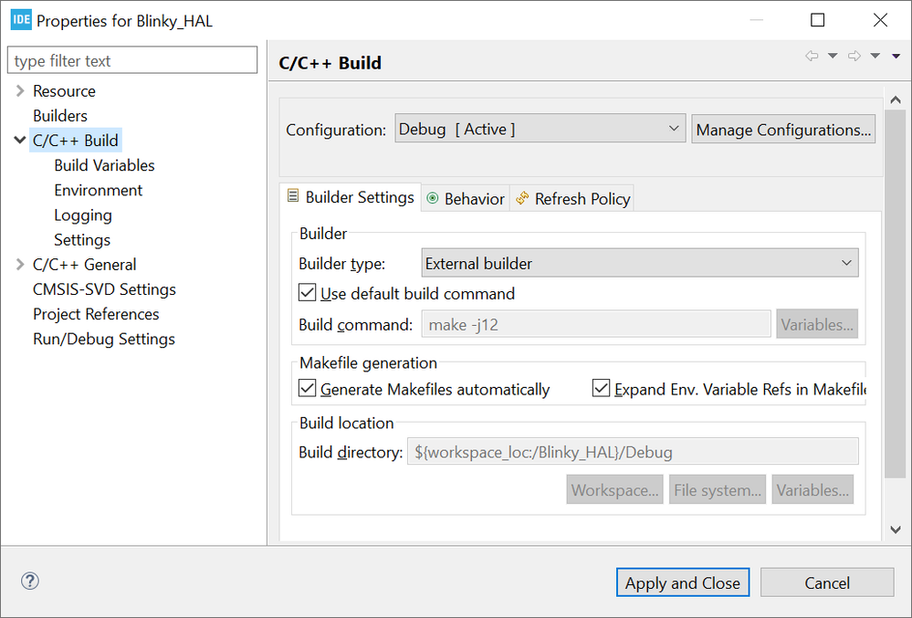

Check Project > Properties > C/C++ Build. It should look like:

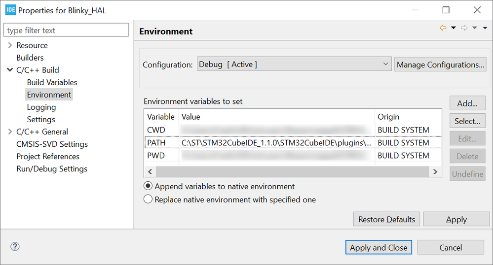

0690X00000DBCqIQAX.pngand Project > Properties > C/C++ Build > Environment contains the path to all tools neded:
The paths are, among others:
C:\ST\STM32CubeIDE_1.1.0\STM32CubeIDE\plugins\com.st.stm32cube.ide.mcu.externaltools.gnu-tools-for-stm32.7-2018-q2-update.win32_1.0.0.201904181610\tools\bin;
C:\ST\STM32CubeIDE_1.1.0\STM32CubeIDE\plugins\com.st.stm32cube.ide.mcu.externaltools.make.win32_1.1.0.201910081157\tools\bin;
Your settings may vary depending on your version and install options, but they should point to the existing tools installed by STMCubeIDE.

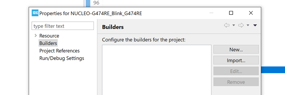

This doesn't look like a STM32 Project at all. Try again creating a new STM32 Project in a new folder from scratch. Follow "How to use STM32CubeIDE" video https://www.youtube.com/watch?v=imXauCiwEfs as close as possible.
