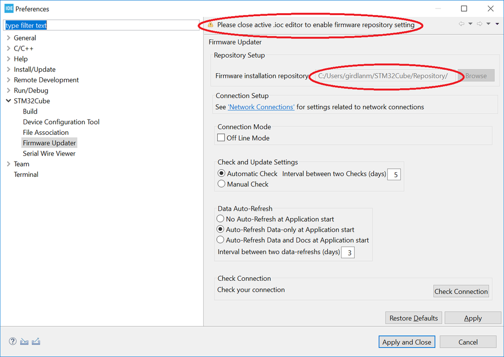

It's only supposed to be greyed out if you have an .ioc editor open. If you close any .ioc editor (even if it's not the active tab) you should be able to edit.
Let me know if it's still greyed out for you after closing.

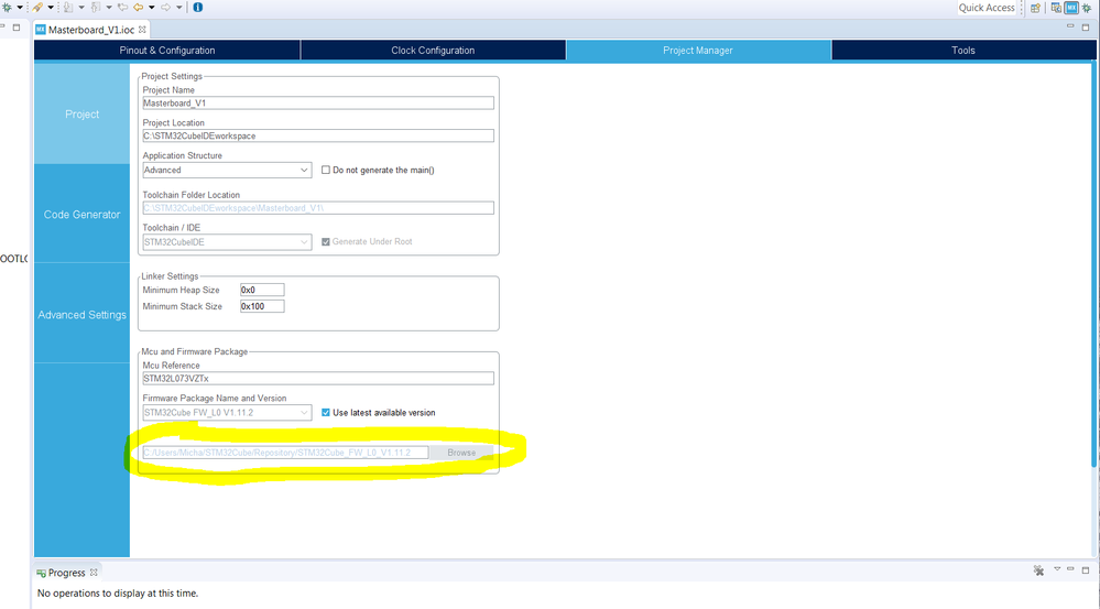

Thank you. actually, I don't really understand you - of course the CubeMX .ioc editor is opened, because I would like to change the path in it. please see the screenshot below.

I understand your confusion, I'm changing the setting through Windows -> Preferences -> STM32Cube.
I'll attach a screenshot:

Sorry about the delayed response. I did some testing as I also had the path remaining.
From what I can tell so far you need to restart the IDE completely after doing the change in Window -> Preferences -> STM32Cube and then it will change inside the .ioc file as well (but only after restart).
This is not intended behavior so I'll make a ticket about improving it.
