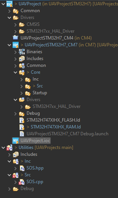

I am working on an STM32 project that utilizes both the CM7 and CM4 cores. I have structured my project to include a static library named Utilities, where I'm facing some challenges with accessing the HAL functionality.
Project Structure:
Utilities
├── .settings
├── Debug
├── Inc
│   └── SOS.hpp
└── Src
    └── SOS.cpp

Here are the compilation errors. I have read "UM2609 Section 2.1.2.2, Creating a new STM32 static library project." My library has no visibility on on those functions or definition for the port or pins. I see how they are used in my dual core executable. But giving my library visibility on them is my problem. Further below I will include screen shots of my C/C++ Build Settings. Maybe I'm missing something there.

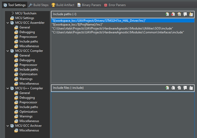

Here is my project structure and include build settings.

I'm making progress. I changed my include to stm32h7xx_hal.h and got an error about selecting a target in stm32h7xx.h. There was a Tip in stm32h7xx.h that suggested adding a preprocessor directive to avoid modifying the header file. So I added STM32H747xx to the preprocessor directives:

Add also USE_HAL_DRIVER to the preprocessor directives.
Hello @mƎALLEm ,
Adding CORE_CM7 to the preprocessor definitions and making a copy of stm32h7xx_hal_conf.h from the CM7 project and adding it to my library project resulted in a clean compile. Though I don't know if it actually works because I'm having unrelated issues and have not been able to test it yet.
