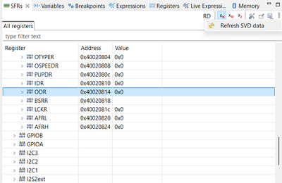

The problem was solved. It was necessary to click the Refresh SVD data button in the SFRs tab (see figure bellow).
Refresh SVD data button locates in the SFRs tab:
1. Navigate to SFRs tab;
2. Click on the 3 dots icon in the SFRs tab;
3. Click Refresh SVD data.
After that, the registers and their values appeared in the SFRs tab.
