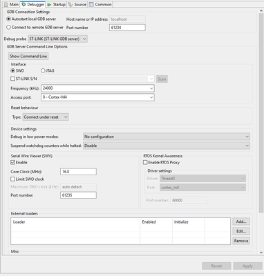

Try erasing the flash using STM32Cubeporgrammer, and make sure to activate the gdb server log in the "Debugger" tab of your debug configuration, this may helped you.

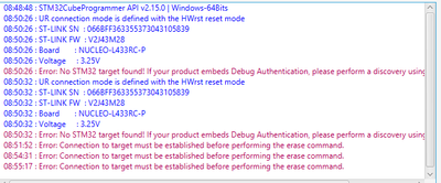

Hi, again! I tried doing a full chip erase but then i got another error message "Connection to target must be established before performing the erase command". I find this very weird since the log clearly shows that it made contact with the chip.
I fulfilled the other suggestions you suggested.

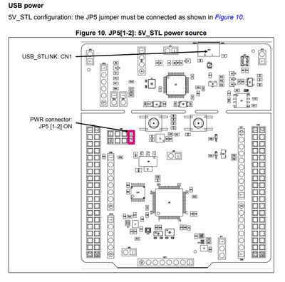

PS: ensure that the JP5 is connected as follow:
Best Regards.

look at the config of the debug ->

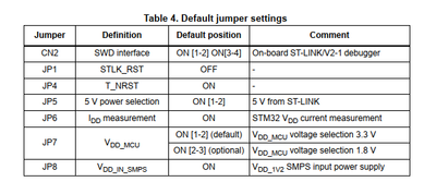

Are you supplying the board via USB? Then try connecting a powered USB hub in between. Sometimes, for example, the power of a USB port in a laptop is not sufficient to supply the board safely.
Are the jumpers on the board set correctly? JP6 (IDD), JP8, CN2
