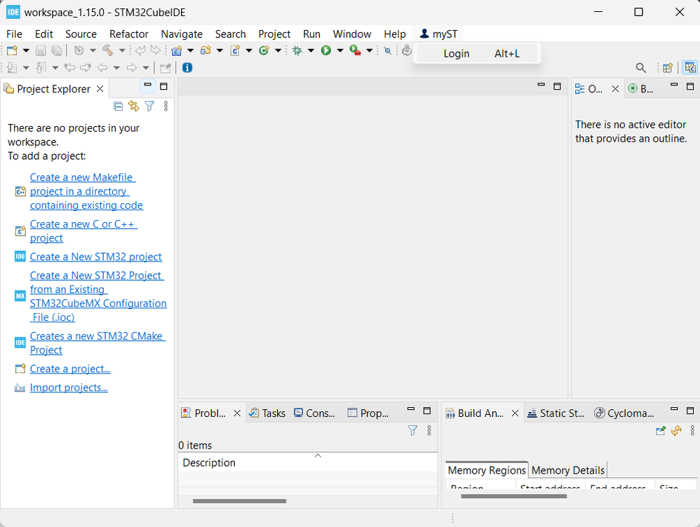

I have an issue when I tried enter myST on STM32CubeIDE 1.15.0 version. Program shows second image and close itself how can I solve this issue?
Best regards.
